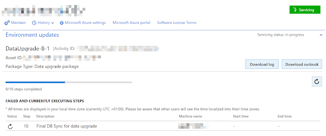

When the database is imported, you will need to head back to LCS and apply the Software Deployable Package created by Microsoft specifically for doing the DataUpgrade. This process will also take some time, but at the end of it, you will have an upgraded database. The package is named DataUpgrade-81 and if you look at its description, it is one single package that upgrades the database from any previous 7.x version to 8.1.
