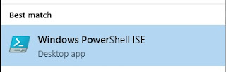

Search and open Windows Powershell ISE as administrator.

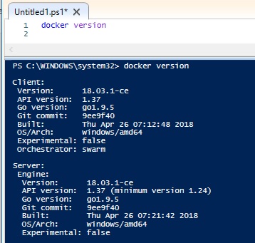

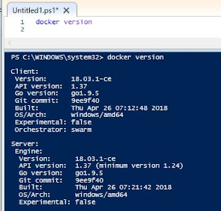

Run command docker version to confirm that docker is installed and running.
If it's installed and running you will see an output as in below screenshot. If not then run the docker from the desktop shortcut or from the start menu.

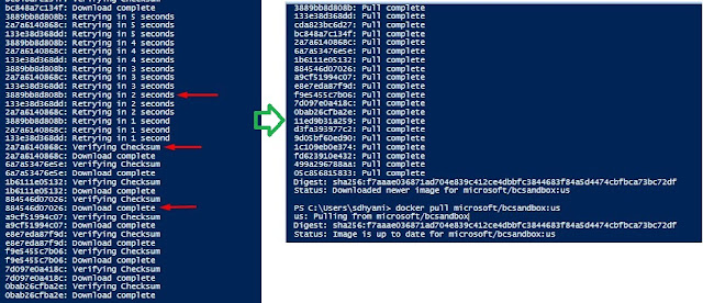

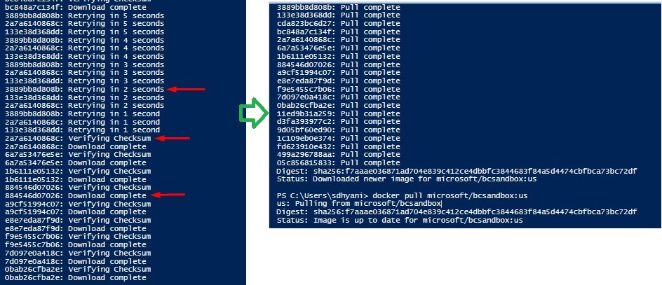

Run command docker pull microsoft/bcsandbox:us to download the image for Business Central US version.
** This command running for the first time will take some time to download, don’t run it on a weak internet connection.

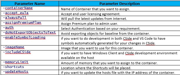

New-NavContainer
For above command, please run using right-hand command panel and specify following parameters as per requirement.
A Sample command for New-NAVContainer is below –
New-NavContainer -containerName sauravMSDYNBC -accept_eula -alwaysPull -assignPremiumPlan -auth NavUserPassword -doNotExportObjectsToText -enableSymbolLoading -imageName microsoft/bcsandbox:us -includeCSide -memoryLimit 3G -shortcuts Desktop -updateHosts

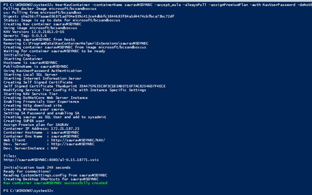

Once­ the PowerShell command is complete, a screen like below as result of PowerShell cmdlet.
Please keep a note of from above screen –
** These values will be used for using this container.
1 Container IP Address
2 Container Hostname
3 Container Dns Name
4 Web Client
5 Dev. Server
6 Dev. ServerInstance
7 Files
Check your desktop, you should have all shortcut icons that are require accessing Business Central Container.
