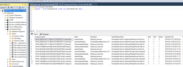

On a Dynamics 365 for Finance & Operations LBD Deployment, can occur that the Deployment fails on a certain step like the SSRS App Deployment, Synch, etc.
In order to check the Deployment status and the running task, you can run the below query against the «OrchestratorData» Database.
use OrchestratorData
select * from RunBookTask order by StartDateTime desc

About the second option, once checked the failed step with the previous query, we have to update the two tables involved in the process and move the State field from 3 to 1 for the specific JobId.
update OrchestratorJob set State = 1 where JobId = 'AXUG-028b0c39-e713-4fb9-b375-52f507df1313'
update RunBookTask set State = 1, Retries = 1 where RunbookTaskId = 'AXUG-028b0c39-e713-4fb9-b375-52f507df1313-setupModules'
About this option, take care because in some cases like Certificates update, recreation of the Credentials.json file, etc. is mandatory handle the deployment through LCS.
