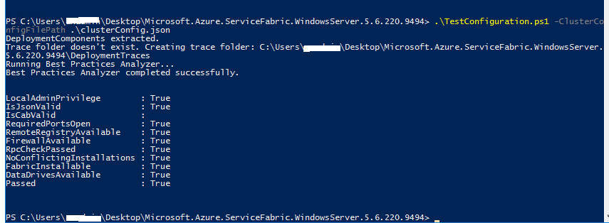

Finally, I test the ClusterConfig file through the command .\TestConfiguration.ps1 -ClusterConfigFilePath .\clusterConfig.json
Next step is Deploy the Cluster!
