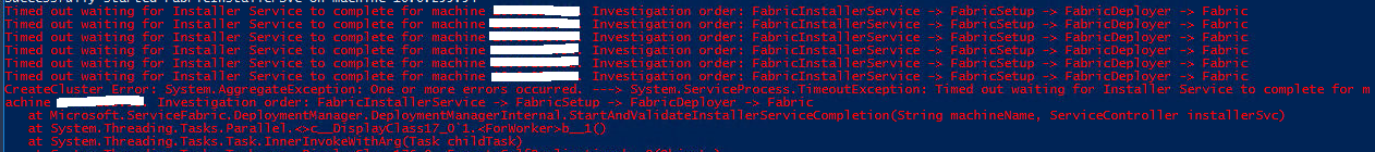

Again, if during the Cluster installation you raised the error "Timed out waiting for Installer Service to complete for machine..."
You have to:
1- Verify if the Certificate are been installed in the Local Machine Node
2- Add the NETWORK SERVICE account for all certs used by Service Fabric.
In order to do this you have first download and install in all Cluster Nodes the WinHttpCertCfg.exe tool, Windows HTTP Services Certificate Configuration Tool (WinHttpCertCfg.exe)
Lastly, run the command for all Certificates in all Cluster Nodes, like "C:\Program Files (x86)\Windows Resource Kits\Tools\WinHttpCertCfg.exe" -g -c LOCAL_MACHINE\MY -s "client.xxxxx.com" -a "NetworkService"
