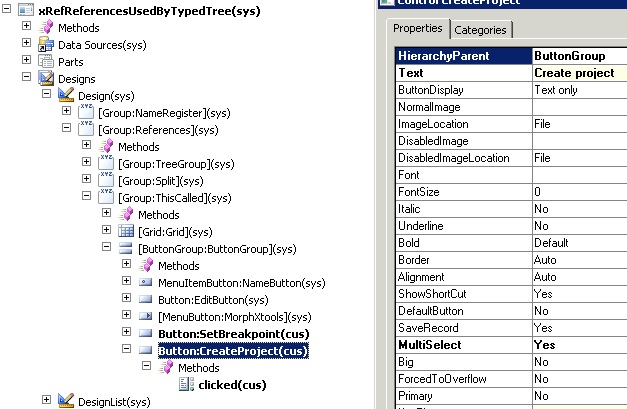

Sometimes one needs to investigate where some field or method is used in the AOT. There may be a long list of AOT paths in the "Used by" form, and having a project with all those application elements may be a good starting point.

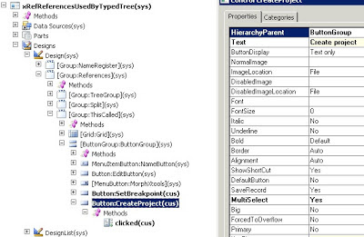

Add a button to xRefReferencesUsedByTypedTree form, set its Text property to "Create project" and MultiSelect to Yes:
Override its clicked method and use the following code:
