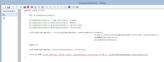

In form init method SysFormEnumComboBox is initialised with 3 enum values, Invoiced value is set as default and selection method is called:

The results are:
init method, after super, SalesStatus selection is 255.
run method, before super, SalesStatus selection is 255.
run method, after super, SalesStatus selection is 3.

1. Add a new map comboBoxItem2EnumValueMap to classDeclaration:
2. Initialise and fill map in init method:
3. Use map in selection method:
The results are:
init method, after super, SalesStatus selection is 3.
run method, before super, SalesStatus selection is 3.
