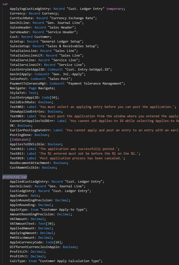

Then, there are also a bunch of other places … which one might wonder .. why those, and not others? Like here you see a bunch of normal variables, and then a bunch of protected ones:
Well, thing is, people have been requesting numerous variables to become “protected” to serve their extension. Just look at these issues on Microsoft’s GitHub for example.
So, keep in mind this is also an option for you: if you need access to table/page/report-variables from the base app, just file your own issue, and Microsoft will respond fairly quickly.
