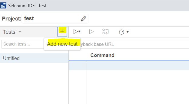

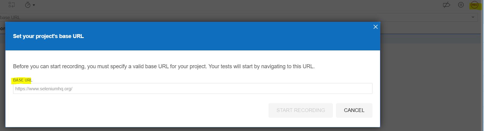

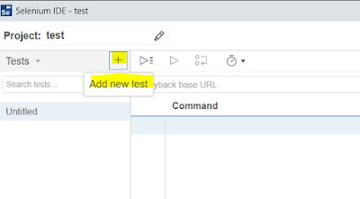

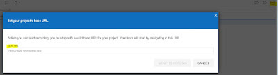

Generate the Recording of the Web application integrated to F&O through Selenium:
Create the Recording:

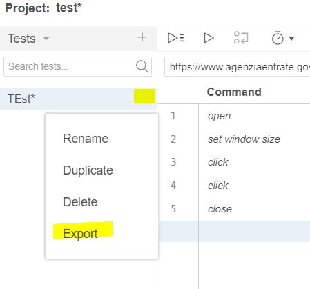

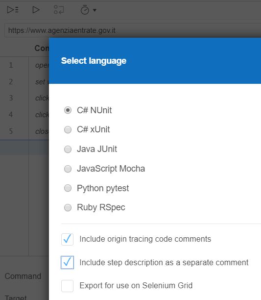

Export\Convert the Recording in a C# unit test file:
The CS file will be looks like this:
