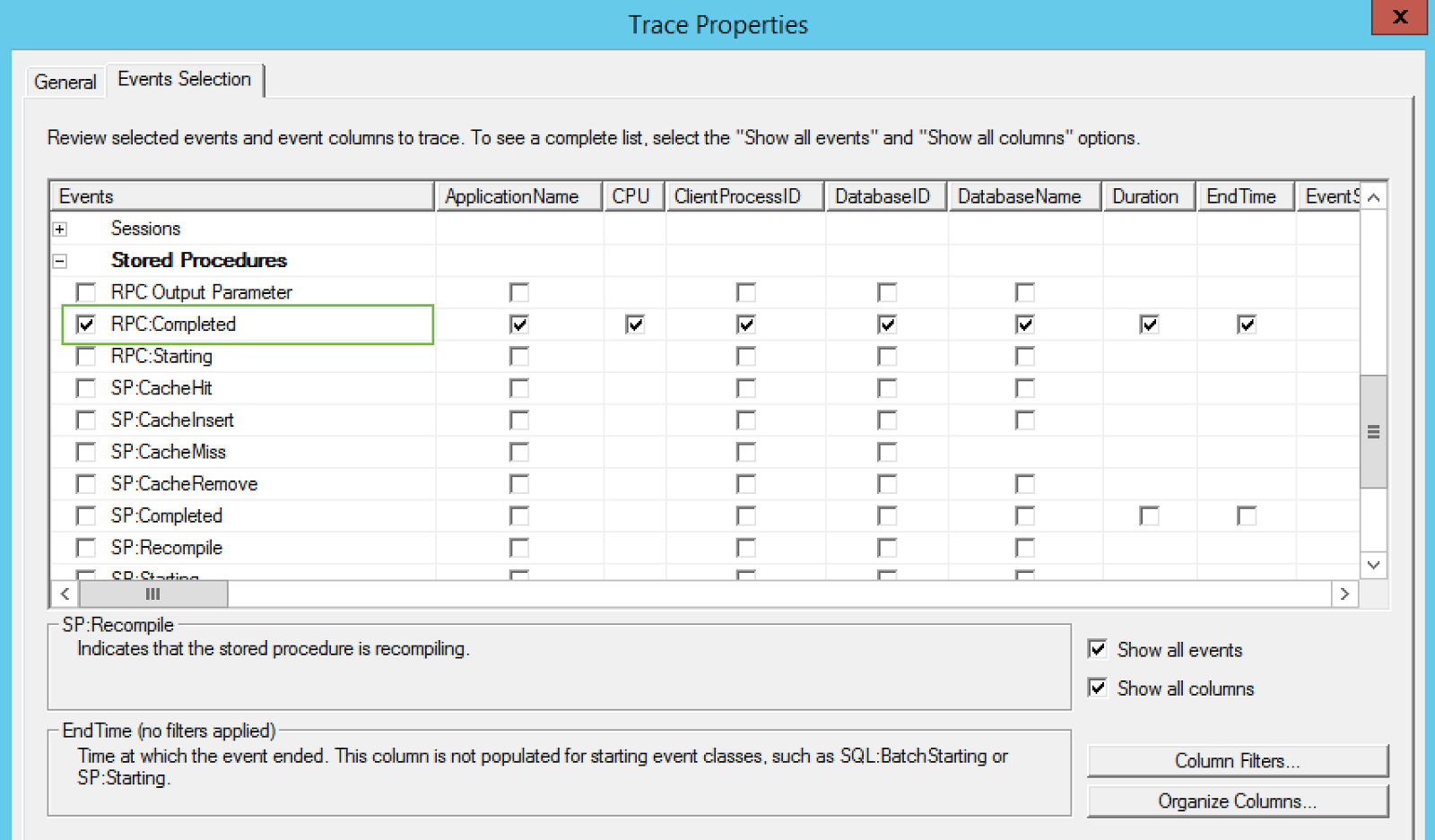

Use the following code and trace RPC:Completed events in SQL Server Profiler.

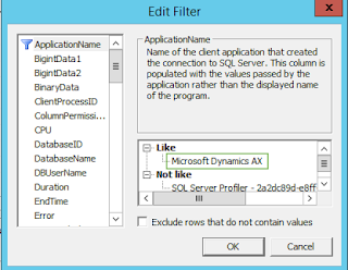

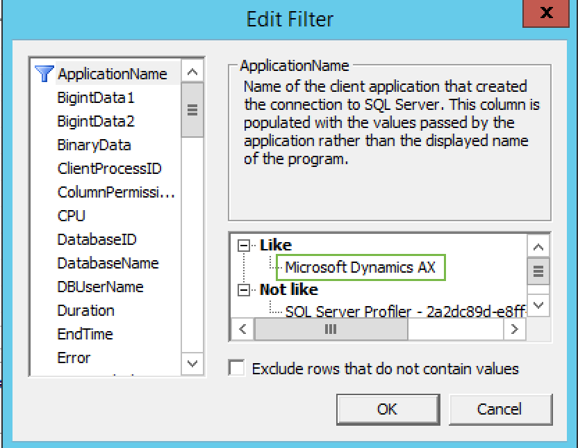

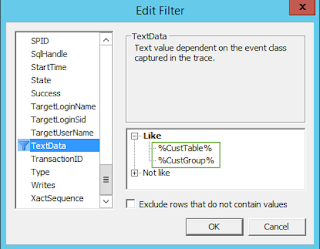

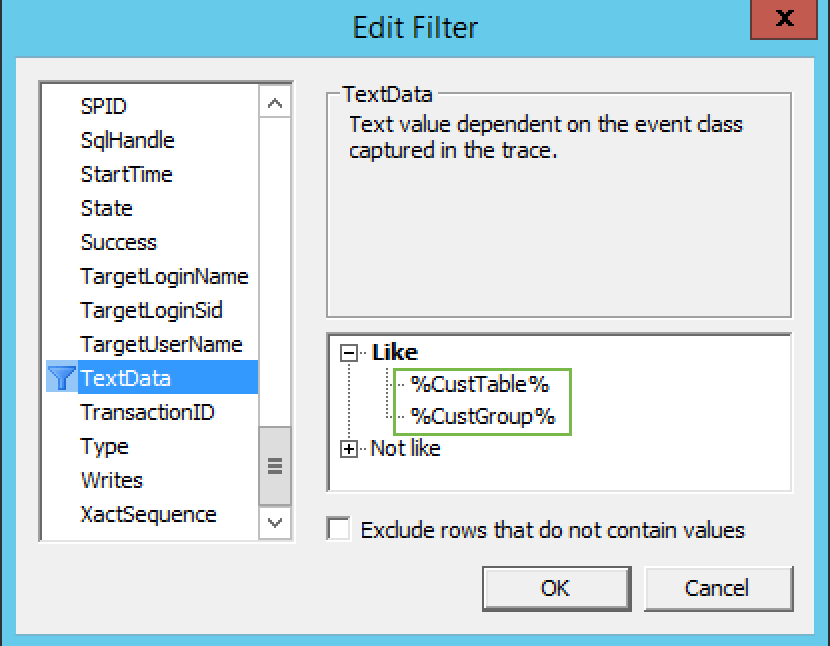

The following settings can be used in SQL Server Profiler
