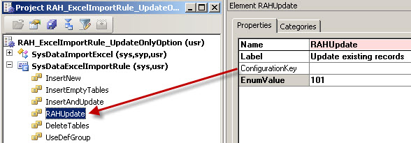

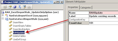

To add a rule that says "Update existing records" only.
Modify Enum SysDataExcelImportRule to add a new element for update.
Note: If you noticed I have inserted new Enum element with value 101, which is far away what Microsoft is using. It is a best practice to keep some difference between the enum values, so if Microsoft inserts new standard enum elements later then our custom enum element do not overlap with the standard. It helps when you upgrade your AX system in future.
