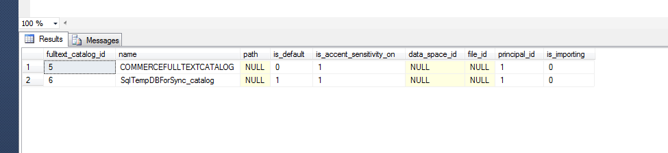

Find the catalog name and change the owner ship like below
Run the command on your database
select * from sys.fulltext_catalogs
Now change the ownership with below script
Example
ALTER AUTHORIZATION ON Fulltext Catalog::[CatalogName] TO [dbo];
Script should be in my case like
ALTER AUTHORIZATION ON Fulltext Catalog::[COMMERCEFULLTEXTCATALOG] TO [dbo];
ALTER AUTHORIZATION ON Fulltext Catalog::[SqlTempDBForSync_catalog] TO [dbo];
