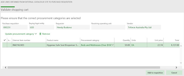

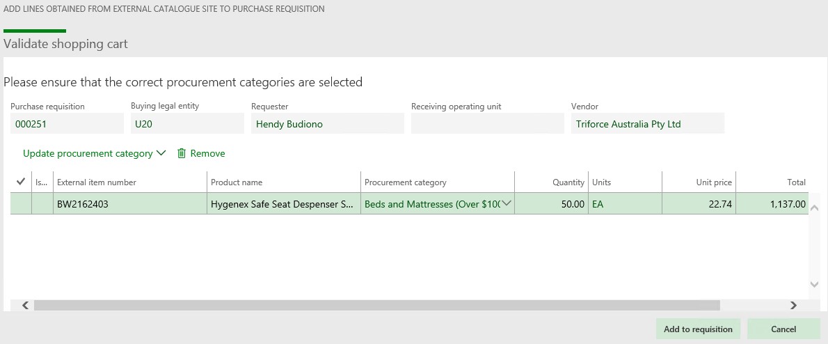

Once you’ve done all that, in the purchase requisition form, you can click the “External catalogues” button on the line section, which will open a dialog where you can choose which vendor’s website that you want to open (based on the configuration that you’ve done on the external catalogues form).
When you click the button, you will get a prompt that says that you will now be redirected to an external site, and after you click OK, you should see the vendor’s website.
You can then place items into the shopping basket, and when you have completed the check out, it will take you back to D365O which gives you the chance to review the order. You can remove lines that you don’t need, or you can choose a different procurement category if needed.
When you click the Add to requisition button at the bottom of the page, it will then transfer the lines into the purchase requisition.
