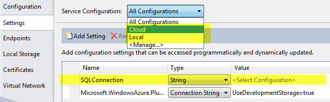

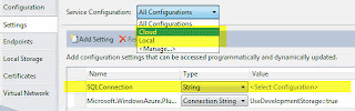

In order to configure the values, right click properties brings us into the setting page that allows developer to add the key into different configuration files.

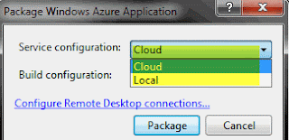

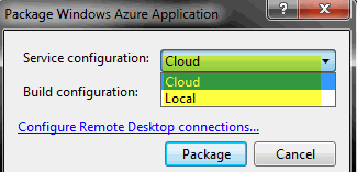

Always remember to select the service configuration that you want to use base on your deployment. To retrieve the value dynamically on run time after deployment, refer below:
Microsoft.WindowsAzure.ServiceRuntime.RoleEnvironment.GetConfigurationSettingValue("SQLConnection")
