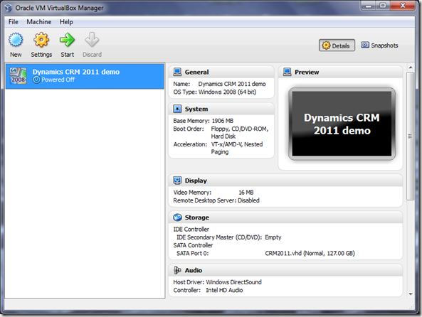

Now that you have installed VirtualBox we need to run it and add our downloaded VPC image to it. To do this we click the ‘New’ button.
The wizard will guide you through adding the VPC image. Set up VirtualBox to run the image as a Windows Server 2008 64 bit
Next you will need to assign memory. The guide suggests 4G RAM but I only have 2G RAM to spare.
Please note: In the end I had to set this to over 2000 MB to avoid the guest blue screening due to running out of memory.
Next you will want to use an existing disk. Browse to the disk you have extracted from the Microsoft demo download.
After this you click ‘Finish’.
If you try to start the image at this point you will see the Blue Screen of Death about five seconds into booting. First we must click on ‘Storage’, remove the SATA hard drive and add it back as an IDE drive. It should look like this when you are done.
Click OK and start up the machine. Many popup boxes appear but once you wade through them it should kick into operation.
