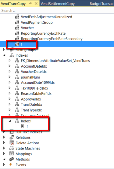

So, find VendTrans table and create a copy into your model. Delete all methods, add new String field f, make a new unique index based on this field and make this index primary and clustered. You do not need either build or synchronize your solution yet.

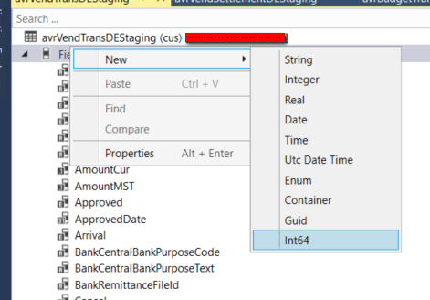

Add a new Int64 field with the same name in the related staging table
Then use it instead of field f in the index and relation.
