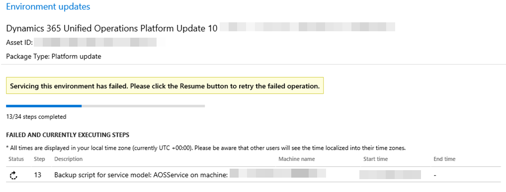

I had an environment running application 1611 with Platform Update 7. I was trying to install Platform Update 10. After it failed on several attempts, I started to try investigate why it failed.
Here are the steps I took.
1) Identify which step failed. In my case it was step 13. (Not exactly my lucky number)

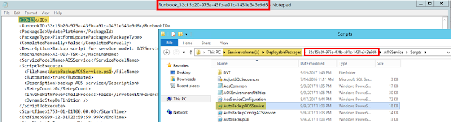

2) Find the runbook output (normally under C:\RunbookOutput) and find the PowerShell Script that fails. I simply searched the log for "13"
3) Open PowerShell ISE in Admin mode and open the PowerShell Script. You will find the script in the J:\DeployablePackages folder, and you can match the GUID from the log with the Runbook folder. The Scripts will be located in a standardized folder path.
