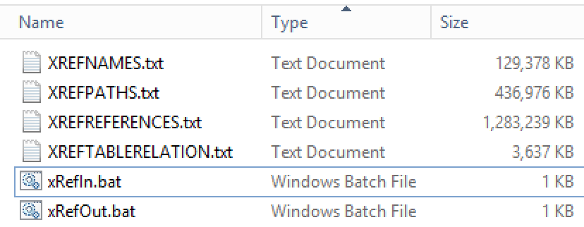

Export took 2 minutes, 4 *.txt files were created in the same folder:
