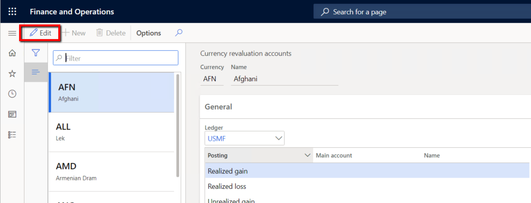

Say, we have to reference Edit button.
For this we use the macro #define.SystemDefinedViewEditButton('SystemDefinedViewEditButton')
The whole list is present in SysSystemDefinedButtons macro
Code snippet for your active method in name_DS
int active()
#SysSystemDefinedButtons
ret = super();
FormCommandButtonControl editButton = element.control(element.controlId(#SystemDefinedViewEditButton)) as FormCommandButtonControl;
editButton.enabled(name_ds.allowEdit());
return ret;
