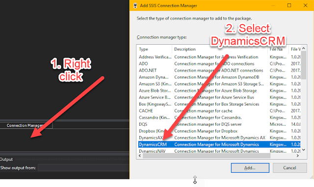

Then start by right clicking in the empty field at the bottom where it says "Connection managers" and choose "New connection..."
In the dialog that shows up choose "DynamicsCRM"

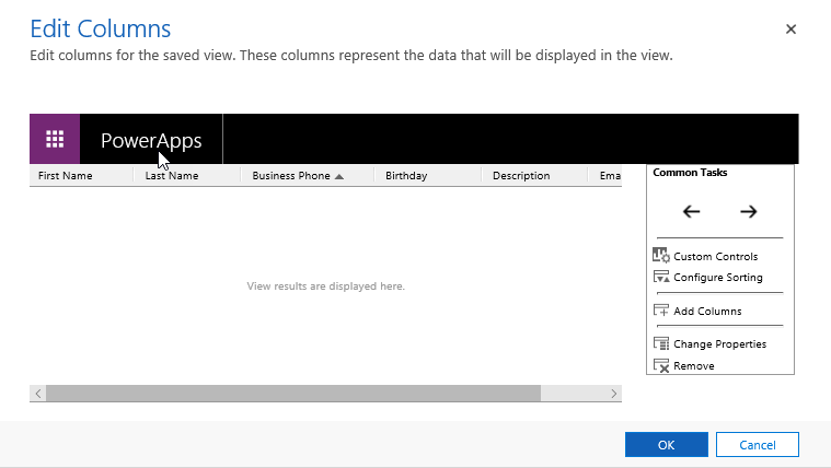

Start by dragging the Dynamics CRM Source from the toolbox (on the left) to the workspace (the big pane in the middle. Then double click it. - Before looking at the details of the source component, I like using FetchXML when building queries and of course the best way to build queries with FetchXML is using FetchXMLBuilder in XrmToolBox (thanks Jonas Rapp and Tanguy Touzard for all your work!) but if that is too much heavy lifting (it really isn't), the easiest way to get a FetchXML query is to make an advance find query and export it with the "Download FetchXML" button in the top right hand side of the ribbon of the Advanced Find query builder. So let's say we have decided the following fields in Contact are personal information and need to be anonymized:
The column editor in advaced find - don't use composite fields like "fullname" or Address1Downloading the FetchXml, and setting the Source component in SSDT (Visual Studio) will make it look like this:

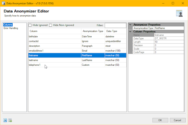

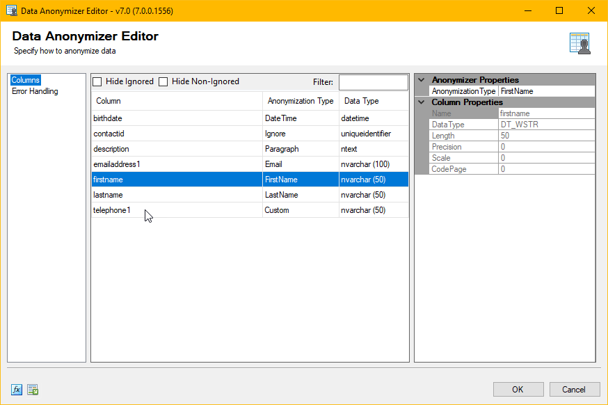

Now add a "Data anonymization" component and drag the arrow from the Source component to the Anonymizer. Then double click the anoymizer.
You should see something like this, where I have set anonymization settings for the different columns. By default it will say "Ignore" on all columns.
Try out the different anonymization types. Some are more generic than others. When done, click Ok and go back the data flow pane. Add a Dynamics CRM Destination and drag the blue arrow from the anonymizer (blue arrows are the normal data output, red arrows are error output) to the Dynamics CRM Destination component. Then double click it. The view in the data flow should look something like the picture below.

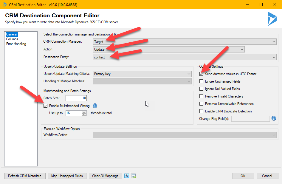

When setting up the destination component, there are a few things to consider:
  • In this case we are always doing updates - hence set the action to update. It is faster than upsert.
  • You have to set the Destination Entity.
  • If you write data to Dyn365 with high latency, no batching and no threads you will be able to update at about 2-3 records per second. With low latency, correct batch setting and multi threading, I have been able to get up to 300 records per second. Very dependant on entity. Hold the mouse of the blue "i" just after the "Enable Multithread Writing" for some deep end tips from the scholars at Kingswaysoft.
  • Error handling is recommended to be directed at a file or some other output where you can monitor it. If you do nothing about it, and you get an error, it will break the flow and stop. You can control error handling of the destination component by clicking on the "Error handling" tab on the left hand side. Remember that all types of exceptions thrown by Dyn365 you will get here as well, like missing rights, disabled records etc.

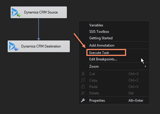

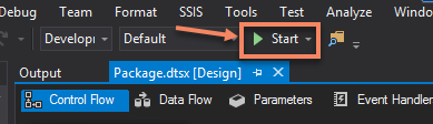

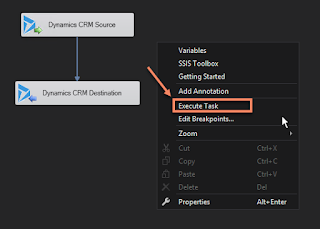

Then you can test run your data flow, by right clicking the data flow pane, and pressing "Execute Task"

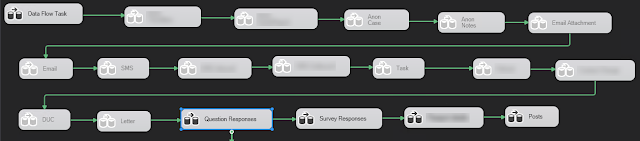

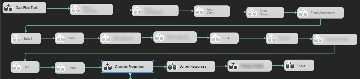

And when you have assemble an larger control flow - like for instance this:
A control flow with several dataflow being disabled - all in sequence.you can execute the entire flow by clicking the green plus sign in the ribbon.
